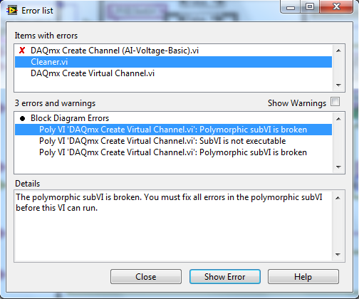

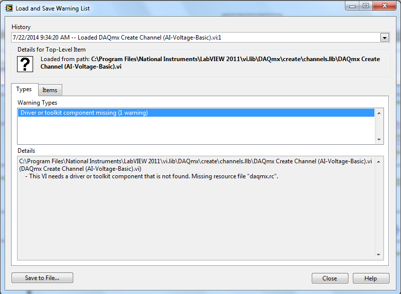

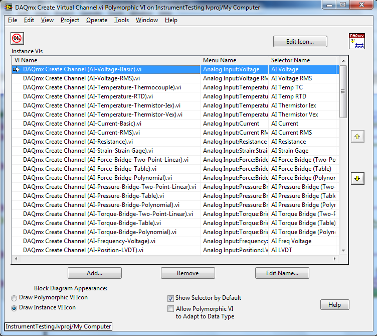

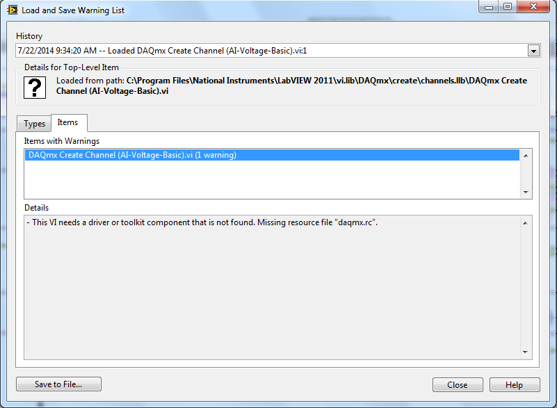

Well I seem to have recorded it slightly off. So when I looked into the DAQmx vi it gave an error and when I clicked show details it gave the following:
When I tried to exit it asked me if I wanted to save the changes, I chose defer decision and eventually chose do not save. I closed labview and reopened the VI, tried to run it and it gave the error:
I selected show error and it gave:
Then where it said it failed to compile was within another vi in the same project. When I first opened it it said SubVI is not executable. When I clicked show error it took me to a VI that had the DAQmx vi in it and it was saying VI failed to compile.
