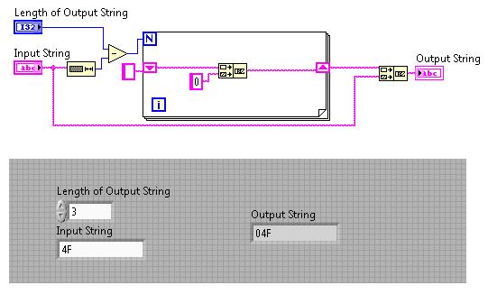

The simplest way that comes to mind is to use a for-loop to iterate and concatenate zeros for each "empty space" calculated by Final String Length - Input String Length.  Then concatenate this with the original string.
For example, here is something I wrote real quick.  There is probably a more elegant solution, but this should be a good starting point:
PadZeros.VI

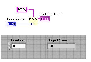

The above doesn't care what the original input string is.  If you want one more specific to hexadecimal, then you can use something with Format Into String:
Padded Hex.vi
The important part of this VI is the format string of "%03x".  The first "0" says to pad the input with zeroes.  The "3" tells you the length of the final string (any strings smaller than that length will get 0 characters to pad it to the requested length).  The "x" tells you it's in hex.
EDIT 2:
The reason "%03x" doesn't worth with String data type inputs is because by default the Format Into String with String data type uses %0 to denote padded spaces.  Either convert your string into a numeric datatype and use the format, or else just use a for-loop as I originally suggested.

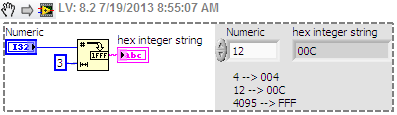

Attached is the circuit I have so far.  Essentially what I need is a number that is between 0-4095 (0-FFF in hex) to be converted to a hex number holding 3 places.
Example:
4 --> 004
12 --> 00C
4095 --> FFF

I must be missing something; this does what your last post says you need.
Jim

Thanks! That was exactly what I needed!
