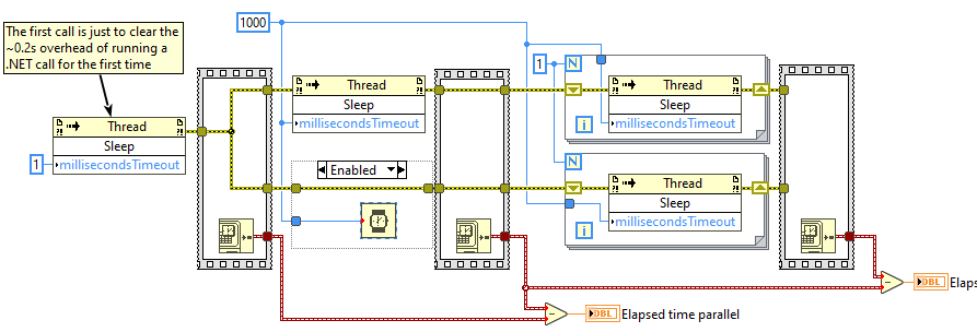

@drjdpowell wrote:
I think McDuff is correct about clumping.  I think the LabVIEW compiler doesn't have information about the execution time of the .NET nodes, and (thinking they execute quickly) clumps them together so they execute serially.
The (brown) "Is Asynchronous?" property gives this information.
This returns "False" for the .NET nodes (probably all .NET nodes).
I think that proves the theory?

wiebe@CARYA wrote:
wiebe@CARYA wrote:
In this particular example (and a few other), it's definitely weird. Calling the same function might be a factor (or not).
Here's a new one...
So I put one Sleep in a VI, running in Other 1. Another in Other 2. Parallel execution still takes 2 seconds.
Than I replaced one .NET sleep with a Wait (ms). It still takes 2 seconds!
So the .NET sleep even competes with the LV wait.
