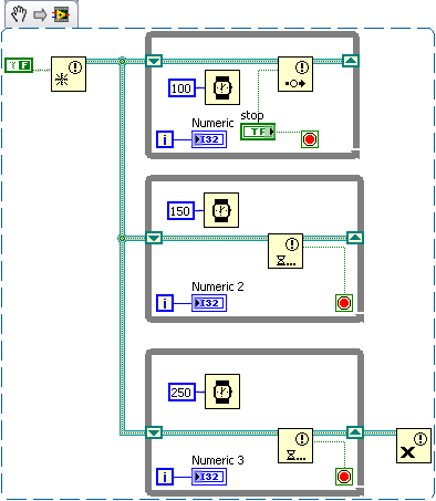

Please refer the attachment. Why do these parallel loops stop completely, sometimes and sometimes, only the loops with lesser wait time stop while the one with higher wait time keeps looping? Is there anyway to stop all the three loops if any event in any of the three loops occurs? By event I mean some sort of safety check or limits violation etc. I do not want to use event structure because I am not comfortable with using it.

Sooner or later you will need to use an Event Structure, I suggest sooner.
I often use Notifiers to stop multiple loops.
With your code, the mechanical action of the stop button is latching, so sometimes when the value is read via the property node the switch returns to False before the slow loop gets around to reading it.  Change it to Switch When Whatever and it will behave as you expect.

Here is a way to use Notifers as Darin suggested.  No need for an Event structure in this simple case.  Also, the stop button can be a latch type.  If things get more complex, an Event structure may become necessary.  Also, a queue can be used to send commands from one loop to other loops (master-slave architecture), with Stop being one of the commands.

The code you have should work. I can see a problem if the button is set to 'switch until released'. Local variable would work also. Of course, the solutions offered earlier are better.
Message 4 of 50
(7,451 Views)
Must be time for a coffee break, the fact that the OP is using a Property node with a Boolean means that the Mech. Action is set to switching so disregard my hypothesis.  Must be some double-clicking going on, and pretty fast at that.
As beaten into the ground at this point, there are much better alternatives anyways.  Local variables should be used very sparingly, and the Value property node used only when locals have been ruled out.

Darin.K wrote:
... Local variables should be used very sparingly, and the Value property node used only when locals have been ruled out.
That is why I used Notifiers in my example.  It works very well.  And you can still have the switch mechanical action set to latch.  When the vi is done, the switch reverts back to false.  No need to re-init.

As already pointed out the code is not elegant but should work (provided you don't re-click the button before the loops are all stopped).
Stronger ways to stop paraller loops make use of occurences (my favourite), queues or notifier, as shown by tbob
(p.s. to see the counter going on you have to set a proper timeout to the Wait on notification vi)
