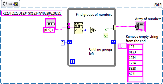

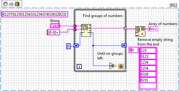

Just a quick regex
(3,530 Views)
@JÞB wrote:
Just a quick regex
A much simpler solution! (I've only been working with LabVIEW for a week or so, so I don't know all the tools yet…)

In LV2012 we can get rid of the last empty element using the conditional tunnel mode.
Ben64
(3,482 Views)
NICE !
(3,461 Views)
