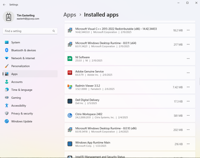

You could try to go through the add remove programs and remove all of the NI software that way.
You might get lucky and it will remove the residual pieces that were left behind by just deleting the folder.

Thank you for the suggestion.
Unfortunately, it says the files are not in the correct location (because they are no longer there at all) and can not remove them due to that. I will look into a forced uninstall but be sure to let me know if there are any other ideas.
