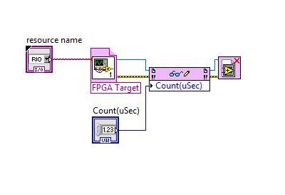

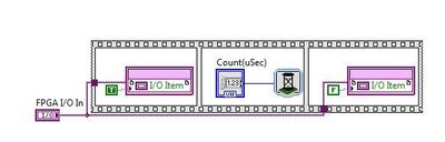

Q.1. I am trying to control an FPGA sub VI from a Non-FPGA Top level VI. I have attached the both VIs. In the FPGA VI, I switch ON a TTL signal in one channel of Connector 0 of 7851R. After some wait time, I switch off the TTL signal in the channel. I want to control the wait time from my Top level Non-FPGA VI. When I run the Top level VI it does call the FPGA VI and I see a TTL rising and falling on the oscilloscope. But the time of this TTL is always a default value of 0 μs i.e. I get this same pulse when I run just the FPGA VI itself with a wait time of 0 μs.  Even if I give a wait time of say 2 μin the Top level VI, the output is always corresponding to that of  0 μs. The FPGA VI when run on its own (without being called from Top level VI) produces the desired output say, 2,5, 10 μs etc.
I would like to control this wait time from Top level VI. Please suggest what I should do.

Here are the screenshots as well:Top Level Non FPGA ViTop Level Non FPGA Vi
FPGA Sub VIFPGA Sub VI

Q1: The FPGA VI has no loop, so it will run just once and terminate. As the FPGA runs (typically) at 40MHz clock the VI will be terminated within ns. Do you really think you can set a Wait time so fast after starting the FPGA that the FPGA will obey your wishes?
Q2: Why don't you try this? Why don't you access FPGA IO directly? Why do you use references with IO nodes?

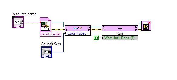

I was able to control the FPGA VI without any loop. I have attached both VIs. Please comment on the suitability of this code.
Also, I still don't get how to access FPGA IO directly from Non-FPGA VI. I went through many examples of LabVIEW. I will keep on trying.Top_level_Non_FPGA_VITop_level_Non_FPGA_VIFPGA_SubVIFPGA_SubVI

Most likely you are running your bitfile on opening the reference.  This means that your code on the FPGA is most likely finished long before you write anything to the FP control.
Add a waiting loop on the FPGA so that you can "trigger" when you want the acquisition to start.  This can be a change in the Timer value (using -1 as a sentinel value) or a boolean, whatever you want.  But you need to force the code you want to execute to receive the data you need to control the timing BEFORE it executes.
