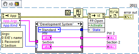

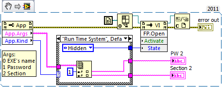

Something that I tend to do with applications that I write that need passed-in arguments, I like to have a case statement that reads FP inputs if the VI is being run in development mode, and to read arguments passed in if it's running in EXE mode. That way when I test out my code by running the VI from LabVIEW, I can just type in the FP inputs that I need to run the code, and still have the same code for the EXE as well.
Running in EXE mode, this case runs:
Running in Development Mode, this case runs:
