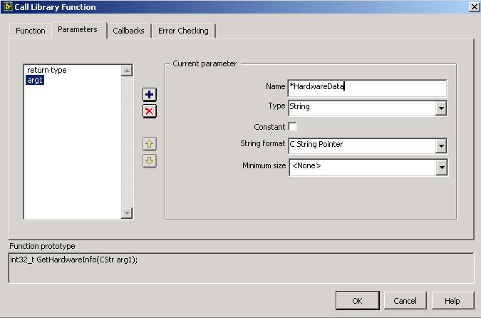

Hello:
How do I pass the (uchar *Hardwaredata) into the DLL?  It is suppose to be a pointer value, I am not sure how to set it up.  What value do I connect to it in the block diagram, is it a string input?

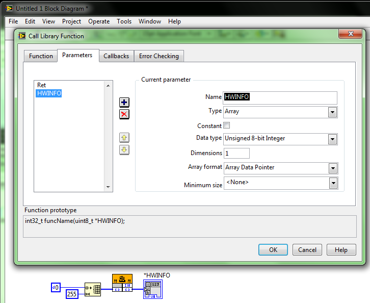

No need to typecast to a string, just pass the array directly:

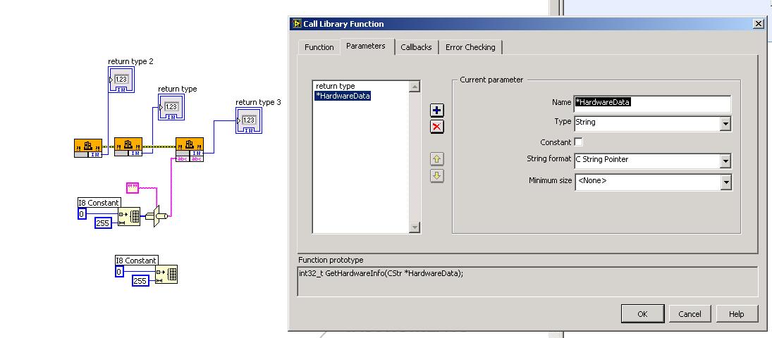

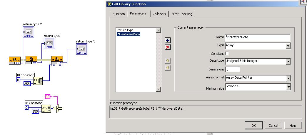

Thanks for all the support guys, unfortunately I tried both methodologies and still having error 1097 for passing the string pointer and the u8 array pointer. See below, am I missing anything else?  I made two queries to the DLL and able to get the correct values back so I know I am connected to the DLL.
