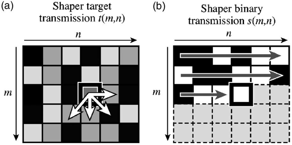

In my program I am calculating pixel values for a binary spatial light modulator. Each time I calculate a value, this value is rounded to either a 0 or a 1. This rounding induces an error that is weighed and then diffused to surrounding unprocessed pixels. But on the edges of the image some surrounding pixels don't exist. You can see this diffusion here:
As you can see in the left bitmap the error is diffused to the surrounding unprocessed pixels. But on the edges these surrounding pixels don't exist.

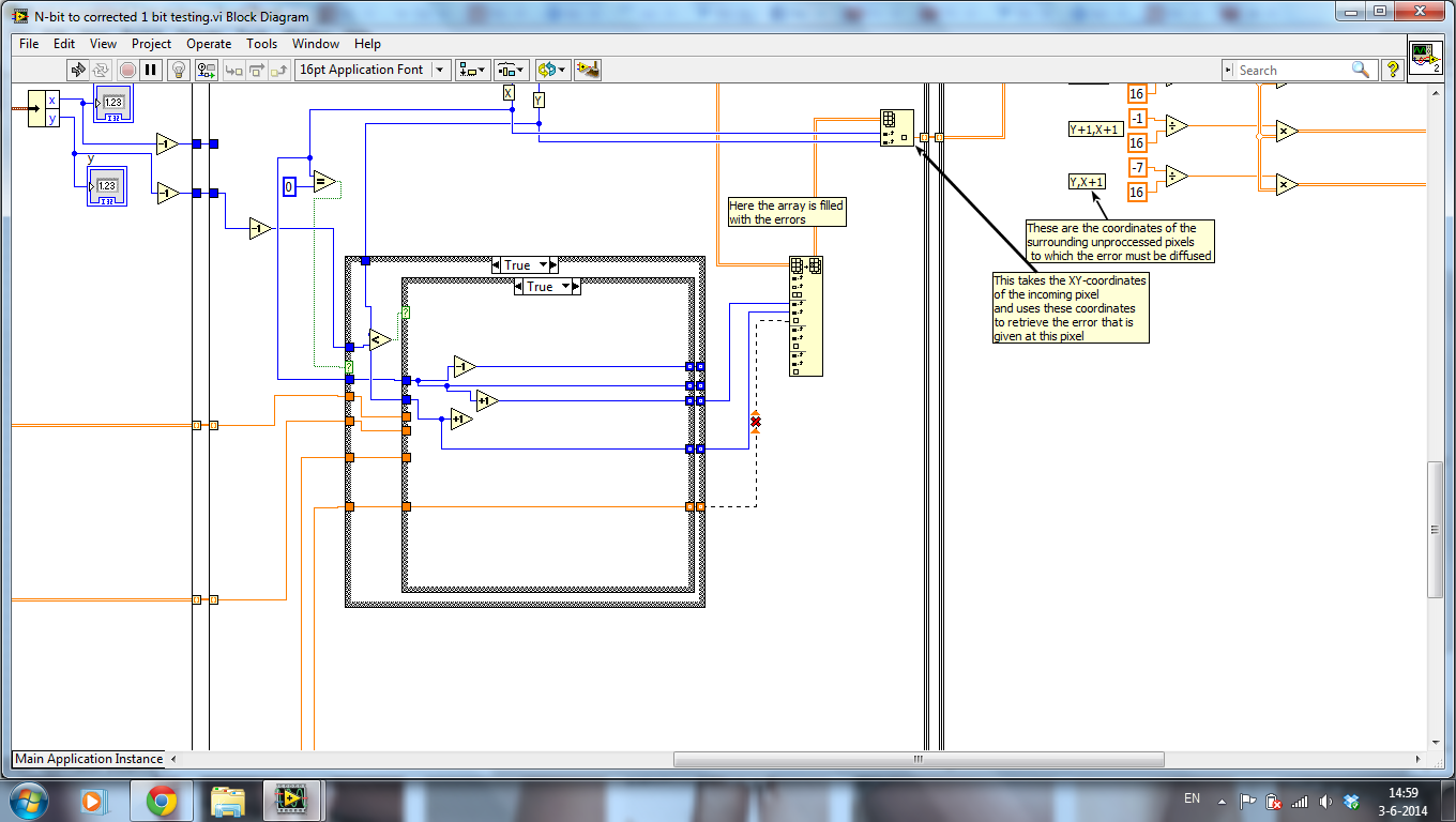

Do you have an example or anything like that? I tried to make one but I am not sure how to combine multiple boolean outputs into one output and then put that into an array. My current attempt was trying to get it to work the way I have already described:
The error it shows is that I hooked up two different arrays. That is strange because the output of the case structure should be a single element, not an array. The autoindexing at the edges of the for loops should have made a single elementof the array-type data that is coming from the left (arrays that are one element in size).
What am I doing wrong here?

I presume you understand what I am trying to do here, so any commentary on my program is welcome.
I want to diffuse the error over the surrounding unprocessed pixels. On the edges this must be different because several pixels are the not available. What I did to realize this is by instead diffusing the error to the surrounding pixels, I diffuse the unused error to the very first pixel: pixel (x=0, y=0).
So I first hook the input of the x-coordinates and Y-coordinates up to case structures (is x=0? If yes, then following question) to find out where the respective pixel is located. Let's say it is located in the right bottom corner. Then there are no pixels to which the error of the calculation can be diffused. So instead of then taking x and y and adding or subtracting 1 of them (for example: x+1,y+1 for the pixel under and to the right of the pixel that is being processed) the coordinates are taken to be zero so the error is diffused to the first pixel.
This has one major issue
Because I am using the replace subset function, I replace one error with another. I want them to add together. If you have any advice that would be great! You can check out my program in its current form, for I have added it to this message.
PS: The program also contains an attempt at opening a DLL file. That does not work at the moment so you can ignore that or even delete it if you want.
PPS: The program requires the Vision module of Labview
(4,036 Views)
Thanks for sharing the code.
I cannot really run the code (missing DLL), but now I have an idea at what your code looks like.
You could have made the code easier to write if you would have created one case structure with the 7 different cases (for example linked to a type defined enum) like Yamaeda mentioned above.
To determine in which one you are you could just use the knowledge of your x and y value and determined in a subVI  right state/case to execute.
Then your code would have basically been:
- 2 nested for-loops (for X and Y direction)
- One subVI to determine state in the inner for loop
- the output "state" of this subVI wired to a case structure
- a case structure with 7 cases which correspond to the 7 possible states/cases
- In each case you then have the appropriate code (probably again in subVIs)
So what you want to do is
- Get the existing ("old") array subset at the right position (use "Array Subset" VI)
- Add the new array subset and the "old" one by using the "Add" VI.
- Then use the "Replace Array Subset" VI.
There can be more optimal ways of doing, but this would be one of the simplest and most readable way to add this at this moment in this code.
