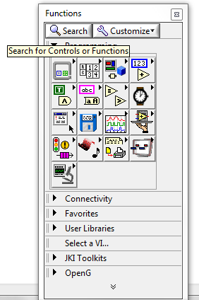

Have you tried the search of the function palette?
Ben64
(4,160 Views)
Yes I did, In vision and motion --> IMAQdx. its not there. Is any problem with version difference becasue when I saw in program files then labview 8.5, 8.6,2009,2010 folders are present. Surprised Smiley Surprised

And also other palette like image processing, IMAQ io is not visible as I installed VDM, VBAI and VAS. Attached image file for reference.

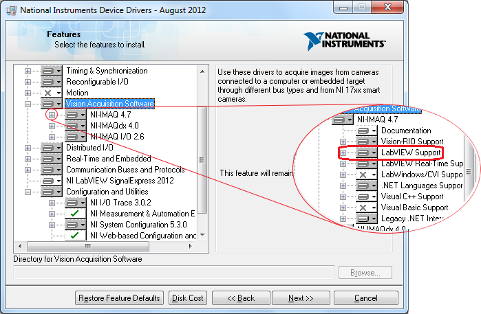

Insert Device Drivers DVD and install
--> NI-IMAQ
--> NI-IMAQ I/O
--> NI-IMAQdx
Don't forget to select LabVIEW support for appropriate (installed) version.

By mistake I installed the older version of VDM, Now it came
