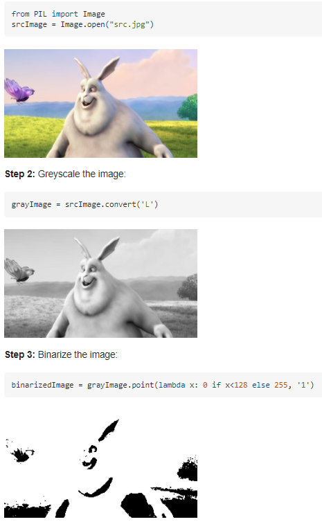

If you are not able to use any library and you only need to use your own code, I would suggest to work with 2D arrays and for loops, you could do a program that normalizes the picture into  a 0-1 matrix, depending of the color or greyscale used in the hand picture; and after that make an image processing again with arrays that you would match the normalized 1s;
Something similar to this, and then match the patter to your expected ouputs
(2,737 Views)

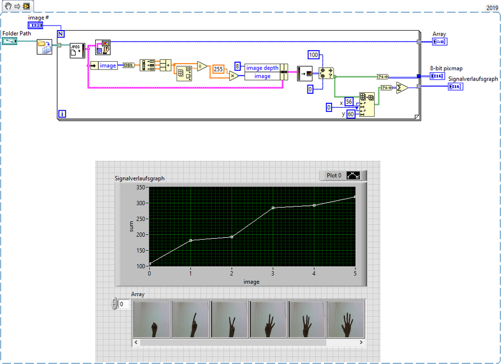

like taking the sum in a region of interest...
picture from https://www.hindawi.com/journals/tswj/2014/267872/
