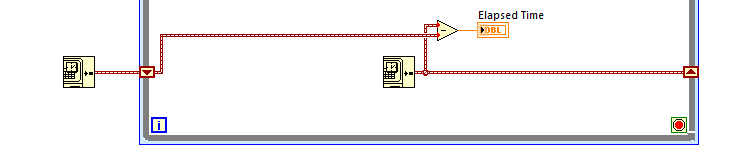

Hello NI Community,
I am attempting to use a timed while loop to run a simulated controller for a mechanical system test. I need the time while loop to run at an even 50 Hz to simulate the controller that will eventually be driving the mechanical system. To verify the rate at which the loop is running, I made a VI that gets a clock value at every loop, and subtracts the current iteration's clock value from the previous iteration's clock value. I have eliminated all other code from this VI except for the clock fetch, to ensure there is no issue with other code in the VI. I'm finding that the elapsed time between iterations is not constant, but is consistent. That is, the elapsed time can change with every loop, but it changes in a specific pattern such that the average of the elapsed times is equal to the setting I'm using for the timed loop. The loop will run faster than asked for several cycles, then slow down for one cycle to even out the time. Here are some examples:
Running at 5 Hz: elapsed time switches between 0.203125 seconds and 0.187500 seconds
Running at 8 Hz: elapsed time is consistently 0.125 seconds.
Running at 10 Hz: elapsed time switches between 0.109375 seconds and 0.093750 seconds
Looking at the differences between the elapsed times and the stability of the 8 Hz setting, it seems like there is a minimum time division of 0.015625 seconds (64 Hz). This is much worse than the 1 ms accuracy claimed in the documentation. What could be causing this?
I am running Windows XP with LabVIEW version 8.5.1, and have observed this behavior on more than one computer using different VIs.
Thank you!
Erik

Attached is the simplest VI I used to show this issue. For me, the elapsed time is not a constant number as I would expect, but swaps back and forth between two numbers as described above. I would really appreciate testing other machines to see if this issue can be duplicated.
Thank you!
Erik

I tried your VI (Win7, Labview2012, Intel Core i7 @ 2.2GHz). Had constant dt to 1e-7.
I would recommend replacing the local variable with a shift register initialised to start time:

Have you tried substituting the Get Timestamp VIs with Tick Count VIs? (At least for testing, they have a maximum output value due to the output number representation).

Your problem is the function you are using to get the current time.  It just gets the time from the Windows clock which has a resolution of 16 msec.
You need to use the Tick Count function like Jarle had pointed out.
