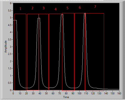

I`m looking for a nice way of splitting a curve up into different parts. The curves can have 1 sweep or n sweeps like in the images.
I can already count the number of peaks and valley but i can`t figure out a neat way of getting the indicies of the highest point of each peak and the lowest point of each valley. I`ve attached a couple of images of what i`m trying to do.
Any ideas most welcome.
James

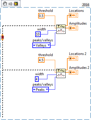

Hello Treble20,
try the function Peak Detector VI.
asdf.pngThe interesting part is to find a good threshold and width setting for the different wave forms.
