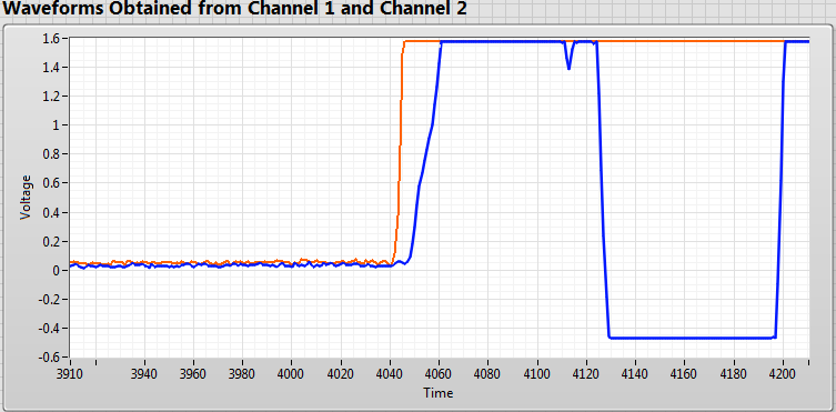

So you only wish to know one delta time
The delta between the orange and the blue?
Where along the rising edge do you wish the measure .2, 1.4 or somewhere inbetween
At the 0.2 V level delta Time is 1.37 nsec
At the 1.4 V level delta Time is  3.00 nsec
Omar

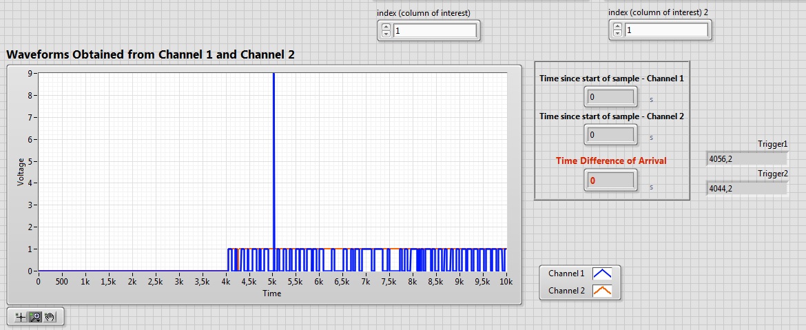

If I want to calculate time difference between these two initial peaks, I do it like this:
4056.2 - 4044.2 = 12. I know that each sample is 0.002E-7 s (according to the spreadsheets).
Then time difference is: 0.002E-7 seconds * 12 samples = 2.4 ns.
I added this part to your VI.. Please have a look.
But here there is a problem, that these points (4056.2 and 4044.2) are not peaks.
I tried to run your VI with my spreadsheets and the picture below represents what I obtained. I tried to optimize the graph to make it look like yours, but I didn`t manage. However, the graph is not of most interest..  The most important is to calculate time difference..

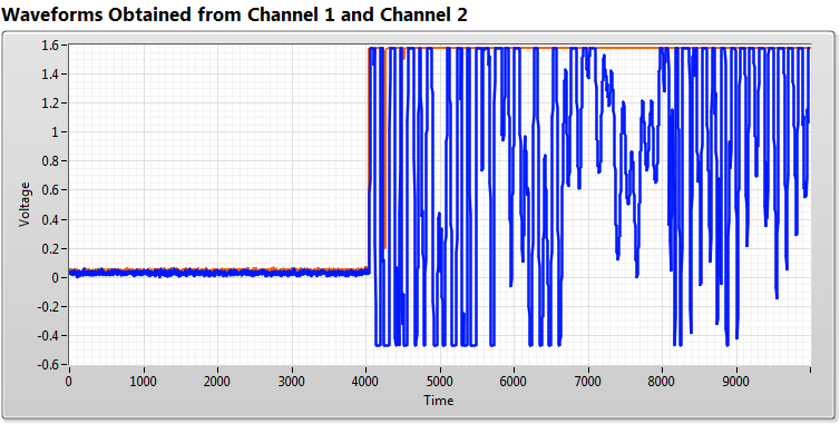

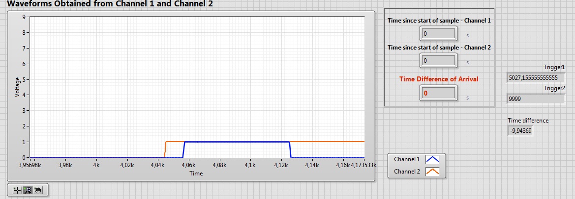

Okay, here are my two speadsheets.
According to them if a threshold is 0.2V, then peaks points are 4051 (channel 2) and 4044 (channel 4). However, the systems says they are 4056,2 and 4044,2 correspondingly. So there is kind of an inaccuracy or something.
Moreover, if I put threshold 1.4V, then peaks points are 4062 (channel 2) and 4047 (channel 4), but the system shows as 5027 and 9999, so it does not really see those peaks.
The picture below represent what type of graph I get. So it is less detailed comparing to yours.

"According to them", "the systems says" who are 'them' and what "systems"
I have only the data files that you posted
Looking into the raw data with Excel the first plot crosses 0.2 somewhere between 4042 and 4043 (at about 0.4 nsec)
The 2nd waveform crosses 0.2 between 4049 and 4050 (at about 1.8 nsec)
The LabVIEW code returns 4042.32 and 4049.17.
I can not see any problem with the values returned using the last data files you sent.
I do not see any  inaccuracy at all.
No problem looking at 1.4 V either.
But again the plots of the data files do not look like the plot you posted in your picture.
Omar
