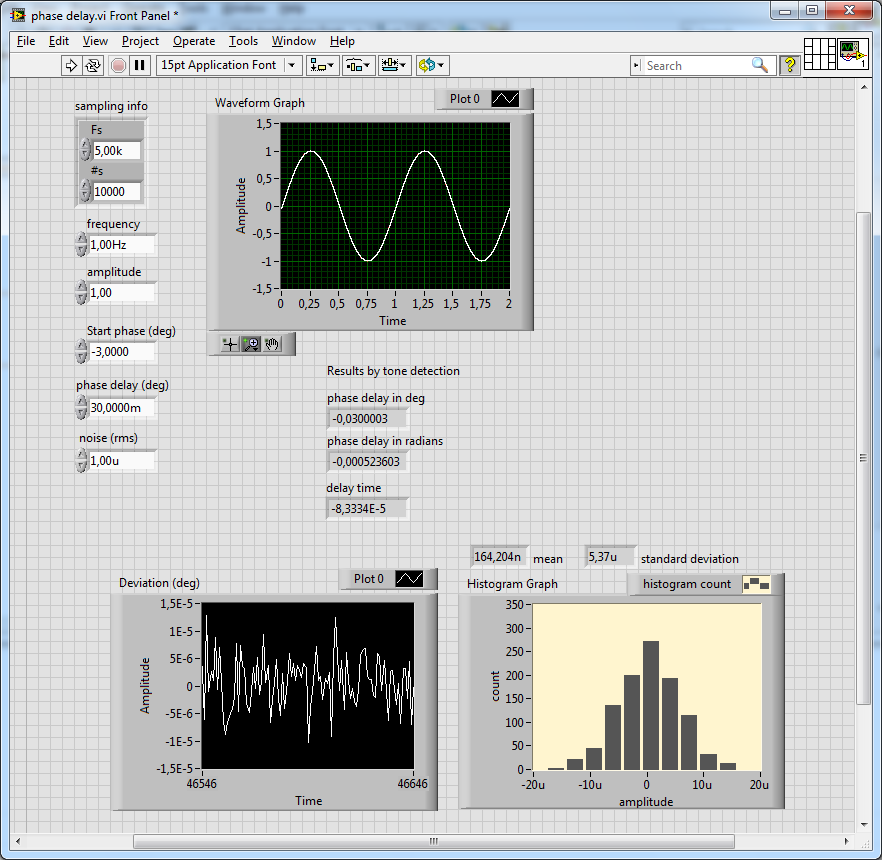

Here is a quick test vi for the extract single tone detection
Play around with the noise , samplerate , number of samples and phase(s)
The histogram will build up if you choose 'run continously' , not nice but quick&dirty 😉

Hello Henriks,
thanks for the quick example. I dont have 2011 though, could you please downconvert it?
I will only be able to look at it at work - I am going tomorrow.
But the attached image answers some important characteristics as I see it.
As we see - the extract tones does not consider the start phase (3deg). It fundamentally looks at the delay (0.03deg)
and thus computes the delay as 0.03 deg, and not 3.03deg.
I have not gone into the mathematics of it, but it appears it does not get affected by the start phase?
All in all, I have done numerous verifications so I am flowing with it. I just wanted to see how does extract tone avoid this pitfall.

What version do you have?
Can you send your vi? Or the part from capture to phase detection?
and the extract tone does consider the start phase,  what is displayed is the difference in phase (defined  30m deg and measured 0.0300003 deg in the pic 😜 )  and what is shown in the histogram is the difference (or error) of the algorythm due to noise between the analytical signals and the result of the two tone extractions from reference and delayed signal.
