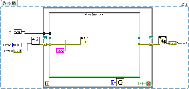

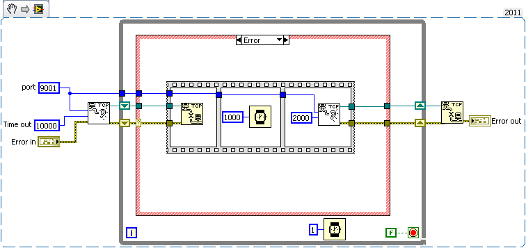

Yes its pretty simple try the attached VI.
Good luck.
(4,268 Views)
