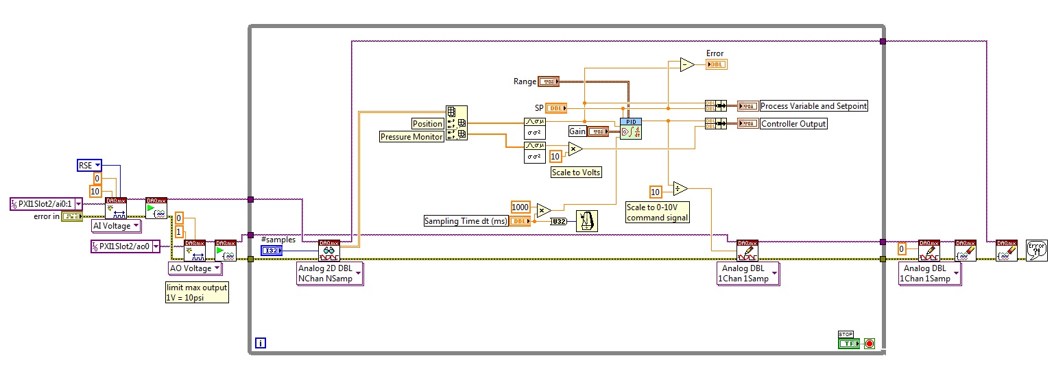

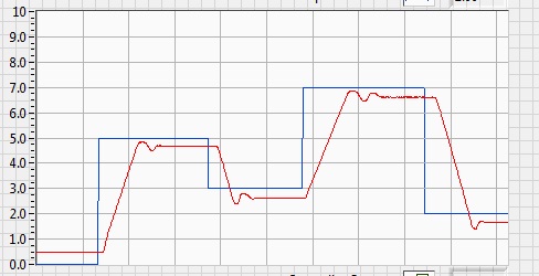

The first crack I took at the control was a simple PID loop, I wasn't expecting this to work perfectly due to the non-linearities of the system, but I gave it a shot. I've attached the response below. I was only able to really operate Proportional-mode only. It was stable, the steady-state error was large (~0.3V at least). Whenever I tried to adjust the Integral gain to account for this, the system would start to oscillate, even if the gain was very small (e.g. 0.0000001). The Derivative gain seemed to have little effect.
I know a PID control scheme is most likely not going to be the right solution to this problem, but still, the fact that even the smallest Integral term created instability made me think I was perhaps doing something wrong.

What was the units of the integral action - was it time ? If so a "gain" of 0.00001 is in fact very very high - if you just want less integral action then you need a longer integral time (e.g. of 10secs)
Consultant Control Engineer
www-isc-ltd.com
(5,732 Views)
Classic problem.  The I value is not the integral gain, it is the integral time - the time required for the integral response to duplicate the proportional response at a constant error.  Internally the PID block divides the proportional gain by the integral time to get the integral gain.  As a result, a very small integral time gives a very large integral gain.  Try using a much larger value and you should see better performance.  Note that the units for integral time are minutes, not seconds.  A tuning approach such as Ziegler-Nichols will get you reasonable initial gains which you can then fine-tune.
For a system like this, PID is a reasonable control method.  Start with proportional-integral and add derivative control only if the response is not too noisy and the response is not fast enough.
(5,731 Views)
Hello colinleer
Are you aware that in PID.vi you are setting integral time, which means: the lower value, the faster integration? So if you set Ti=0.0000001, you actually set extremely high integral gain! Start with higher value.
I don't know much about pistons, could you tell why you consider this system to be nonlinear? Looking just at the plots it seems to be working very well.

Wow, it's great when the solution is right in front of your face...the system is working much better now!
Thanks for everyone's help
