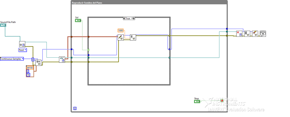

Like that?

When i try it, i heard the sound in a infinite loop
(7,435 Views)
Accepted by topic author Gabriel1010
First run in Finite Mode. Then also take the Write Sound VI outside the loop so you only write the data once.
Then make sure to configure the Sound Output Configure VI with the exact same number of samples as your file signal.
Finally add a Sound Output Start / Wait and Stop inside your loop.
That way you are going to play the exact signal once every time you press your button.
Btw... remember to wire through the False case as well, otherwise you will not pass a valid session to your close VIs.

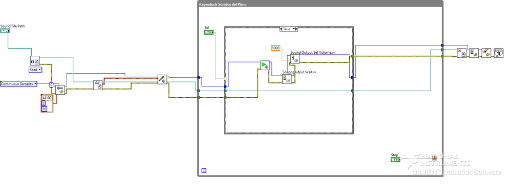

it works, but with a lot of lag response. If i play the sound one time, i need to wait like 2 seconds to play it again.i need to have a very fast response, because this is gonna be a piano application

This likely because you have not adapted the number of samples/ch in your configuration VI to your actual waveform length. The default is 100.000 so you'll have to play a little more than 2 sec before you can re-play.
