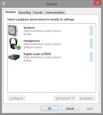

Hi LP-tst,
If Windows is showing two (or more) sound devices, you should be able to use them simultaneously from within LabVIEW. My laptop supports both Speaker and Headphone output (when the headphones are plugged in), and I can access them both and playback sounds simultaneously, even though only one of them is the default device.

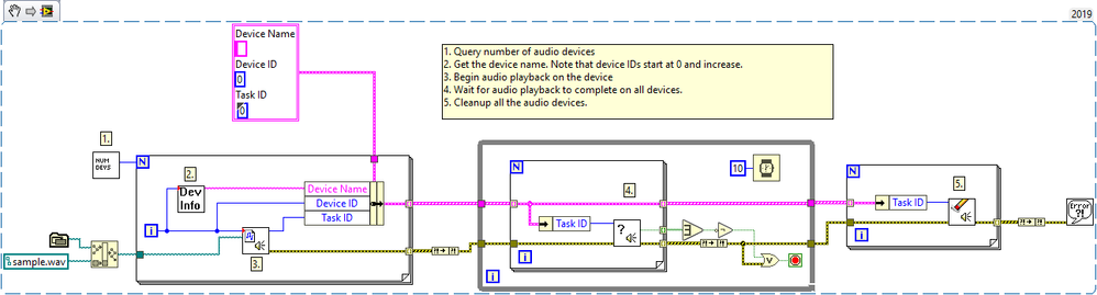

Within LabVIEW there are a few VIs hidden in lvsound2.llb (specifically Get Num Devices.vi and Sound Device Info.vi) which help with determining the number of available output devices and their names. You can use this info to open multiple sound devices, and playback audio using both. See the attached code example.
I'm working on an open source DJ app written entirely in LabVIEW, and one of the features is simultaneous audio output on multiple devices (master + headphone cueing). Feel free to poke around the code for details on how the simultaneous output is being done.
One thing to note is that LabVIEW only enumerates the sound devices when it first starts, so you'll need to have all of the audio devices available in Windows before starting LabVIEW.
