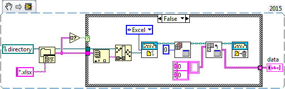

Basically I need to know how to pull an excel sheet into my VI from a folder that contains 2 files (one is a .doc and the other .xls) for this I'm attempting to use the List folder function.
I know I can use a filepath to do this, but the file name changes periodically so I'd rather just grab the only .xls (if possible)
From that excel workbook, i need to access data that is on another sheet. I've been playing around with the front panel of the workbook properties but i'm not having any luck.
Any tips are much appreciated.

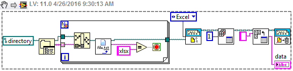

This will get an xlsx file from the directory.  It doesn't handle the situation where a valid xlsx file is not found.
Do you have the report generation toolkit?  If so, switching to a different worksheet is a trivial thing, since there is a VI created to do that.

You can use the pattern input of the List Folder.vi to search for .xls  (.xlsx in my example). The Get Worksheet function is zero base so it should be set to 0 to get the first sheet. Data type should be a 2D array of string, with a string constant you will only get the content of the first cell in the range. In the true case you can insert a dialog that warn that no file was found.
