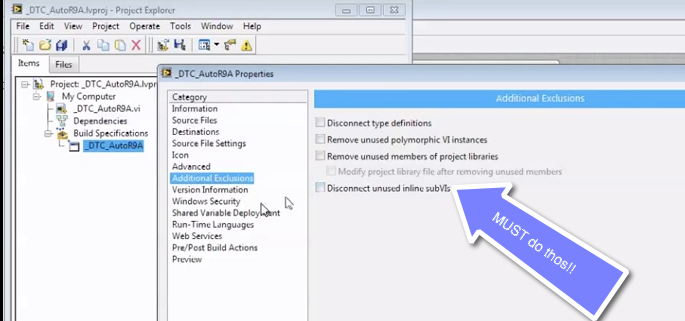

Here is how to fix your broken arrow. It TOTALLY works if your DEBUGGING VI works!
I tried to delete my original posting above but could not.. Sooo here is more complete info with an image of the Exe builder..
Two of you contacted me and after I said to do this it worked! You can not skip this part...
DO NOT skip this part! This is the MAGIC that makes it work! It shows up at 0:32 in the video!

How to Fix Your LabVIEW Failed to Compile or LabView Broken Arrow on Compile.
If you have a happy vi running in LabVIEW and it has a happy arrow then it SHOULD compile to an executable. RIGHT??!! NOT... Frequently, especially if the project is LARGE, it will not properly compile!
I show you how you can compile EVEN when you have a broken arrow!
When LabVIEW fails on building an executable it sometimes does not show you WHERE the error is. It also tells you that you need files that you are not using! Go figure! This is because some of the files are ignored that should not be ignored.

BTW: When you do the simple build executable at the end of the video you will get a complete and happy lvproj file that you can do other stuff with. Do not try to re-build a new executable with THAT lvproj. You need to start another one just like I showed. It SHOULD work but it does not. There is some silly bug that does not properly "link" all of the files. So, keep it simple and just do a new one. It is fast and free with the Tools/Build Executable.
