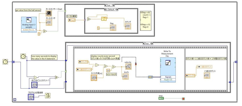

This is my code.

     The picture of your Block Diagram is difficult to read, has some broken/missing wires, and doesn't let us see all the details necessary to help you.  For example, writing to Measurement file says it can save to Excel -- we should test out your code.

I think you don't have to convert numeric data to dynamic data before connecting to 'Write to measurement file' express VI.
You can just directly connect the velocity data to the express VI.
Btw, we do have tutorial regarding 'Write to measurement file' express VI.
Feel free to take a look for your reference.
