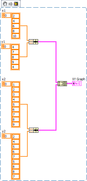

If you hover over the BD terminal of the XY graph it shows you how to get multiple plots, just build an array of individual XY plots.

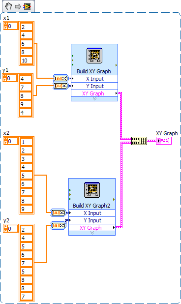

With a name like "Express XY Graph" it has to be good.  Allow me to list a few things I use more often than Express VIs:  local variables, global variables, stacked sequence structures.  Now that I think about it, I use Express VIs about as often as I use the Stop Function.
If you really wanted to see the glory of the "Express" version, you can create your Express XY Graph.  Copy the Helper VI, use build array to get an array of the output graphs and feed that to the graph.  As an added bonus you get lovely conversions of the data from array to dynamic data.  I feel guilty showing this, just remember, friends don't let friends do this:
