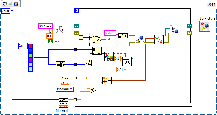

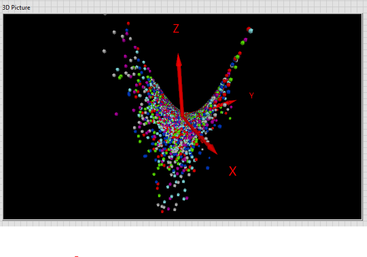

What is the time you are looking for? I used the 3D Picture control with colored sphered to create a graph and I was able to get less then 1 s.

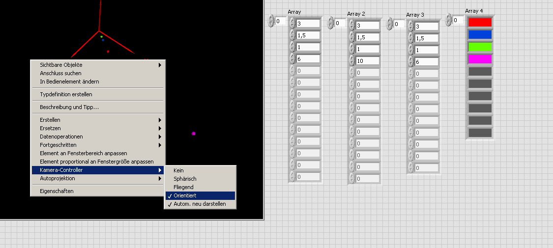

first, right click the 3d plot and set the camera-control to "oriented":
then try to zoom out by pressing shift + drag the mouse during left-clicking

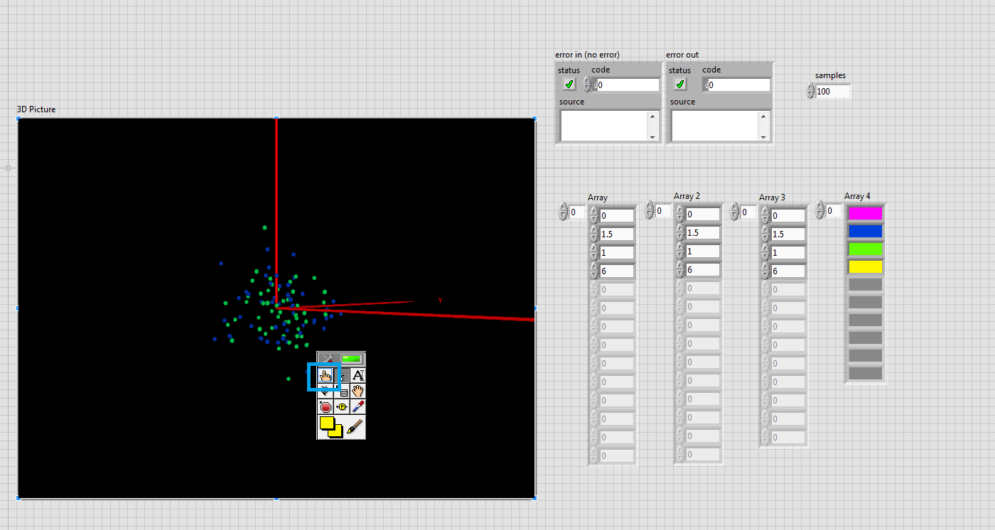

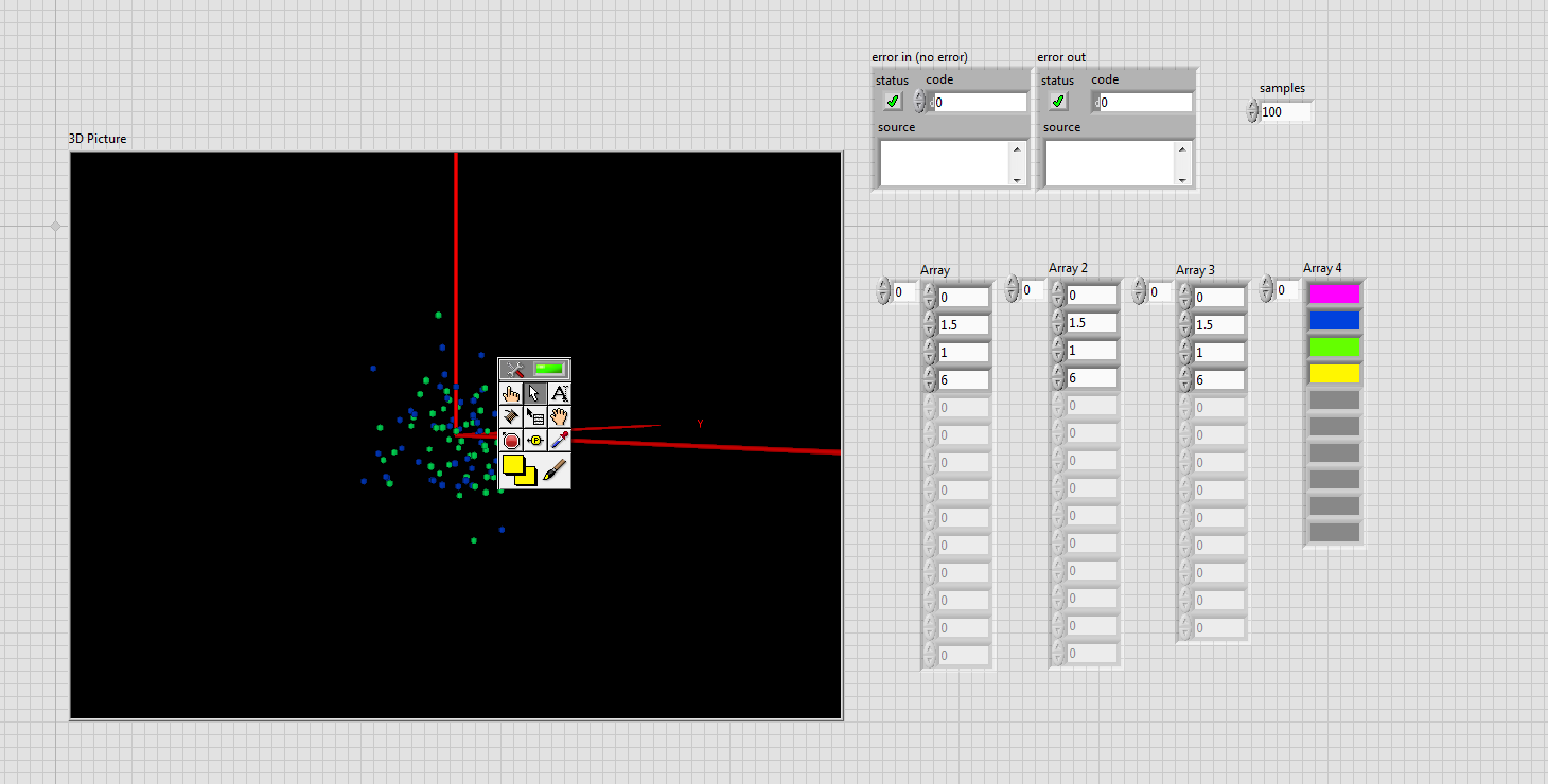

I just want to add a few more snapshots to clear the procedure even more.
Procedure to tilt/rotate/Zoom in/out of the garph
Step 0: Follow the guidelines given by @alexderjuengere in the previous post. Right click on 3d picture-> Camera controller-> check "orinted" and "Auto redraw".
Step 1: Again go to the front panel. Bring the mouse over the 3D plot and Shift+ right click. You should see something like this.
Step 2: Click on the finger tool as shown in the image by the Blue rectangle.
Step 3: To rotate/tilt- hover above the 3d picture and left click+drag.
Step 4: To zoom in/out- hover above the 3d picture, Shift+Left click+Drag
Kudoes to all who contributed to this awesome solution!
