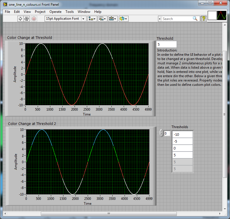

I am working on a project that reads data from a com port and graphs the data.  For one set of data, I need to check to see if the data is above/below a threshold.  I would like the color for the data that is in between the upper and lower thresholds to be a certain color, and the data that is above or below to be to be a different color than the safe range.  I have figured out how to get either the above or below to work but not at the same time.  Here is an example vi that depicts what I have done so far but is simplified to the extent you do not need to receive any data.  Any help on this would be appreciated.

I add some code to your solution using the same principle (adding NAN-lines)  😉
How many colors you want? Just add thresholds in the array 🙂
Still room for improvements 😉
look, there are gaps between the lines, and the -10 should be -INF 😉

Thank you for your input.  What you did helped me to understand what I needed to do.  I knew it was something simple, just had some trouble getting it done.
