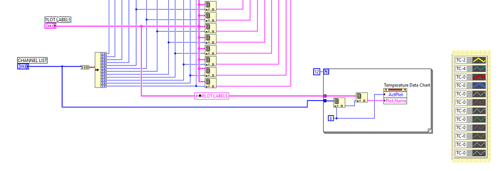

I have an odd issue with the plot legend not showing up with the correct label placement on the chart.  It is in a sub vi that selects the data wanted to be displayed ( out of 20) for a list box and plots those only but, when I select more that one it arranges them not as expected.  If I select one it is correct and puts one at the top however when I select two it puts the least significant at the bottom and as I select more it starts again at the top.  I have tried switching the order of the active plot numbers but it still wants to out the next selection at the bottom of the list which puts all of the legend off buy one.

Property nodes execute from top to bottom. Set the active plot first, then set the plot name.

I thought of that to and did give it a try but I had the same results.

It may be acting unpredictably because you have all those property nodes running in parallel. It works fine (how I think you want it to look) when I set the active plot first. I hardwired a value of 12 to the for loop so all of the remaining plots are labeled TC-0, but you can get the value programatically.

Thank you for your help and this indeed does work a lot  better than  my original parallel scheme.
