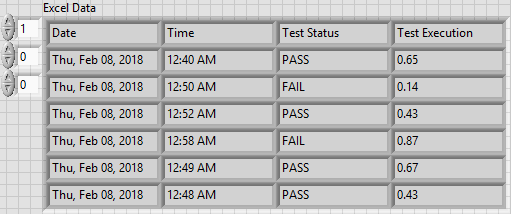

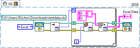

There are two things to consider:  Getting the data from Excel using the RGT, and making plots from what you get.  The code below does the first part, and gives you a 3-D Array with the first index representing the index of the Excel Worksheet (I'm showing Index 1, or Sheet 2), and the other two indices being the rows and columns of the Worksheet.  I did everything as Strings, and left the header row intact (you can tell Excel Get Data to start reading from Row 1, if you want to skip the header).  I'll leave it to you to parse rows and columns in order to construct the (LabVIEW) plots you want to make.
The first function, New Report, opens your existing Workbook.  The second function, Excel Get Workbook Properties, returns the number of Worksheets.  The For Loop uses Excel Get Worksheet and Excel Get Data to get the Worksheet contents as a 2D array of Strings, and the final function, Dispose Report, closes Excel.
