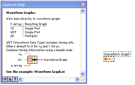

If you would simply turn on Context Help, you would see this when you move your mouse over a graph indicator. To plot two 1D arrays, use the Build Array function to create a 2D array.
Message Edited by Dennis Knutson on 03-30-2008 07:52 PM
