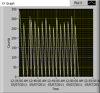

Plotting 2D string array
Hi, I need to create a xy-graph that plots a 2D string array.  The first - and every other entry is a timestamp.  Each timestamp must plot (in sequence) along the x-axis.  Each constant that follows cooresponds to the preceeding timestamp and must be plotted accordingly along the y-axis labelled 'Counts'.  Keep in mind I will also need to expand this to allow multiple spreadsheets with the same format to be plotted on the same graph.  Please, see attached and thank you for your help!

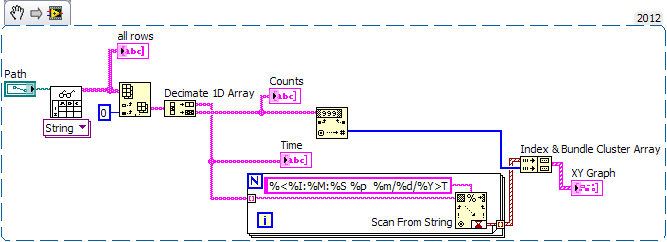

Are you trying to generate a graph that looks like this? If so, see attached code (VI is saved for 2011 to match your upload, but the snippet is in 2012).

To answer your first question. Yes, each text file will be read from a file.  To answer the second part - actually, I am starting from a 2D string array and trying to produce the xy-graph using only the contents of each text file.  Thank you for your reponse.

Thank you,  I had actually tried using decimate 1D array and a for loop previously.  I was missing the scan from string idea however - and running out of time!. 🙂
