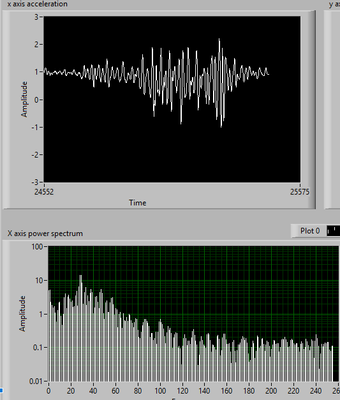

I am trying to do FFT on the signal from accelerometer. I have an array of 512 that i need to plot repeatable. I tried using a Express VI for Power Spectrum or plotting real part of of FFT or the modulus showing on x-axis the nr. of samples/2.
First graph is plotting acceleration in g-units, the second is power spectrum on logarithmic scale.
I want to plot the power spectrum by frequency for vibration analysis, knowing that sample rate is 200Hz.
Can anyone help me with some ideas. Thanks in advance.

I attached the VI. I take data from accelerometer via serial, and store it in 3 arrays. Now, I'm trying to plot FFT for vibration analysis for the 3 axes.
Tried with expressVI, plotting real part or plotting modulus value, but there's no input for calculating frequency on horizontal axis.

I have inserted a build waveform block before Spectral Measurements block with dt=0.005 and the values on horizontal axis are from 0 to 1.2 which is still incorrect.
I am missing something, but I don't know what.

Well, I need to compute FFT on an 1D array with 256 values. Values are from -4 to 4 and represents acceleration. My sample rate is 200Hz(i read the ADC every 5ms). I tried to build a waveform like you said but the values on frequency axis are wrong.(tested with a sine of 50 Hz )
