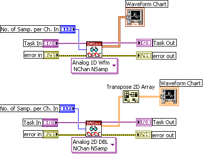

I am acquiring 100 samples at the rate of 5000 samples / sec, for two analog channels.
I am using a hardware timing source so that a Timed loop fires once every (100/5000 = 0.02 sec) and the DAQMX Read VI is inside this Timed Loop.
I have just shown the reading and plotting part alone in the enclosed Sub-VI.
If you look at the VI, you will notice that though I am acquiring 100 samples per channel, I am only using one sample per channel due to the second indexing that has to be done prior to feeding the same to the Waveform Chart. I tried avoiding the second indexing and directly built the signal with the outputs of the First Indexing and the chart went crazy.
I need to know how to send all the 100 samples / ch that I am acquiring to the Wave Form chart. ( I am constrained to use only the chart and cannot use the graph as the plot needs to be scrolled back etc )

Hi Raghunathan,
what about this:
I replaced your DAQmx part with two for loops to play with... I think the "transpose" will solve your problems with charts "going crazy". (You should really learn to describe your problems betterSmiley Wink)

Hi GerdW,
Your simple example was good to play around with and when run with "Highlight Execution" can follow  exactly how the array is built.
Now there is no problem in getting a neat plot with about 100 samples each channel at the rate of 2.5kHz ( yes I had toned down the frequency ) .
