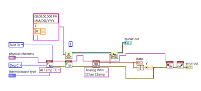

I am trying to graph anywhere from a few up to 32 thermocouples vs time, below is what I have so far but the chart only show beginning and end times which does not help much. Is it possible to get the chart to fill in more on the x axis ? Ideally the time would be relative and in HH:MM. The chart is set to abosolute time with the x axis autoscaled.

In the block diagram, right click on the waveform chart, select Create -> Property Node. Then you can scroll down until you find the adjustable properties for the X scale. Increment is one of them.

It appears my issue was overlooking the scale representation options. Thank you for your help.

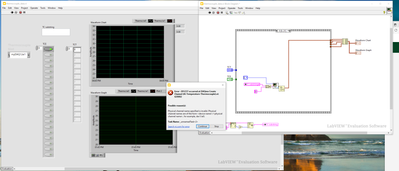

Question - How do you resolve this error? I hooked up an E-type thermocouple to ports AI 0+/0-. Any help would be greatly appreciated.

Hi electroq,
use a valid channel name…
Btw. cleaning up that old VI would also be a good idea:
Delete the queue in the subVI and wire the waveform to the connector pane!

I am. The myDAQ channel selected appears in the drop down and is the channel used via cable to computer. Not sure what to change here.

It's hard to know exactly without your VI attached but I'm not sure you're using the myDAQ1/ai1 as the actual input to your DAQ create function. It looks like the TC substring is being used as the input (concatenated with 0) and that looks to be empty.
If you haven't already I'd start by searching for "thermocouple" in the example finder (Help -> Find Examples). If you're having issues getting hardware to work starting with the shipping examples is a good first step.

Hi electroq,
Debug your VI!
That VI tries to use several input channels and even manipulates their channel name: are you sure the VI is using the correct channel name internally? ("Sure" in the sense of "Yes, I debugged my VI and made sure it is accessing the correct channel(s) in all DAQmx tasks!")
