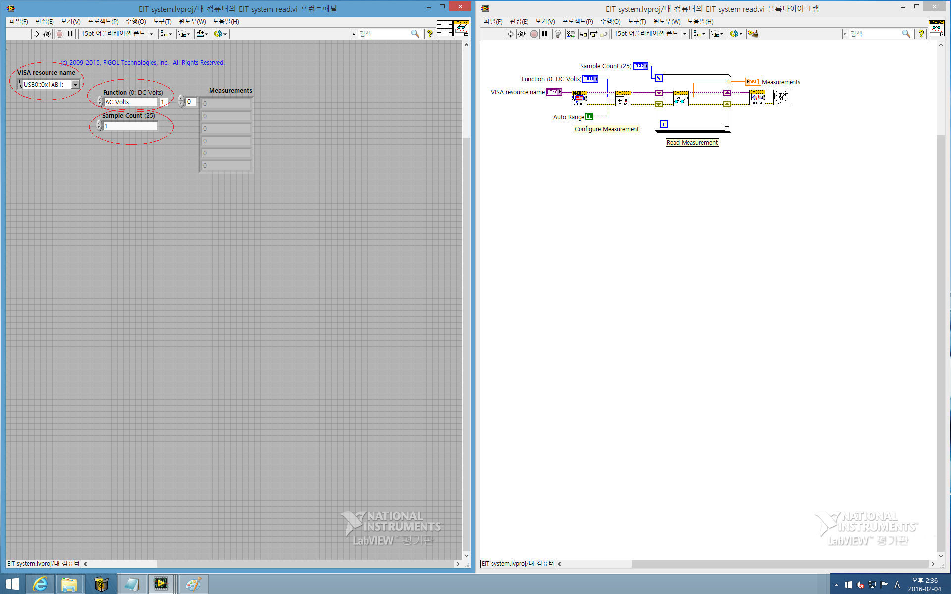

Here is my program based on DM 3k series driver

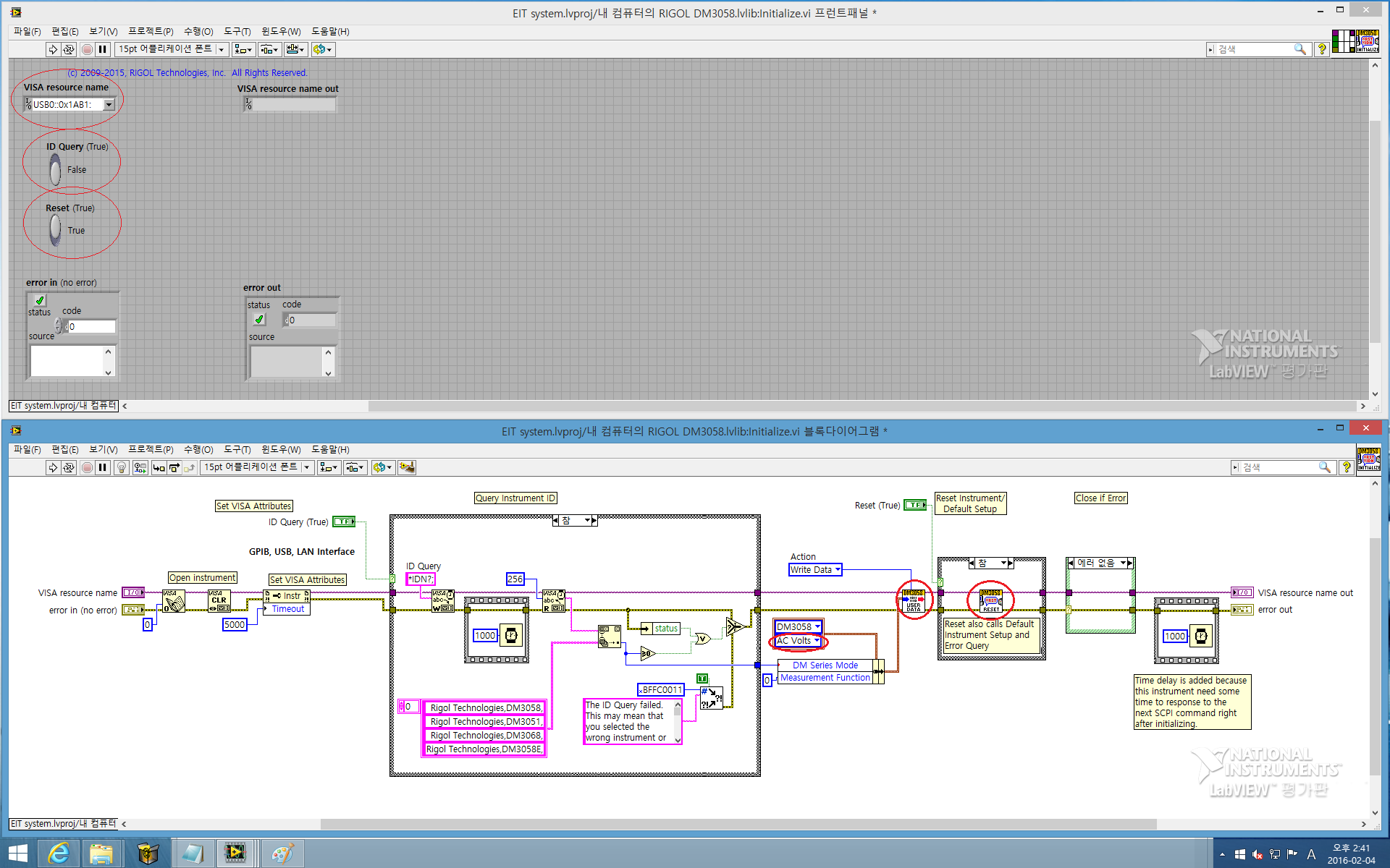

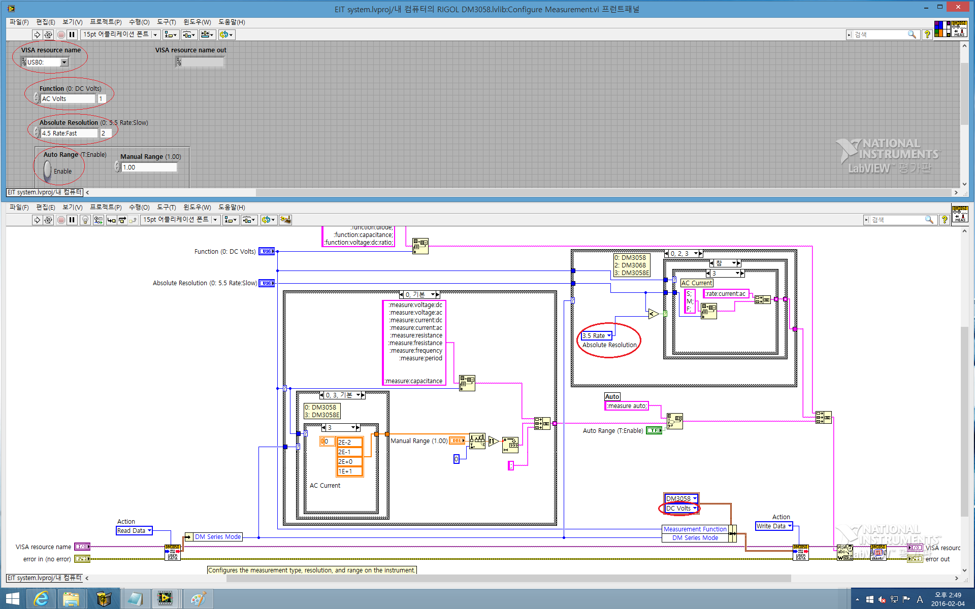

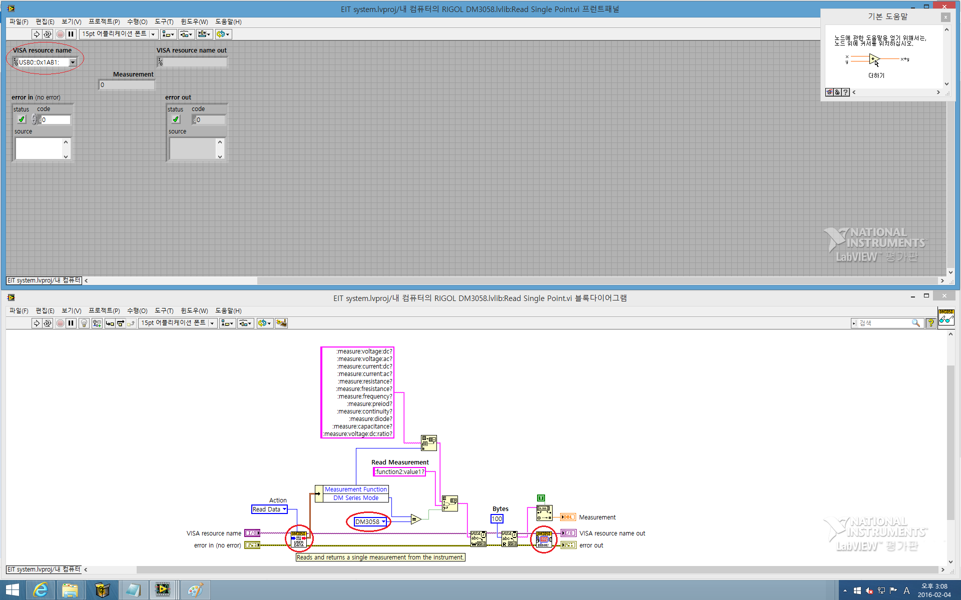

This is the error report
Instrument reports:
-113,"Undefined header; keyword cannot be found"
0,"No error"
RIGOL DM3058.lvlib:Error Query.vi
RIGOL DM3058.lvlib:Configure Measurement.vi
EIT system read.vi

Instrument reports: -113,"Undefined header; keyword cannot be found"
Read the (programming) manual of your device. It explains each command and their (valid) options. (Cross-)Check each command you send to the device…
