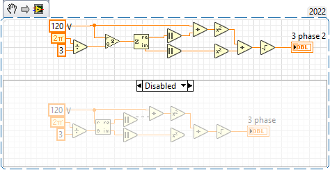

While explaining basic household electrical distribution I ran across this annoyance demonstrated by the above snippet.  Apparently x = r*cos(theta) looses the Volts unit of Rho.  Strangely, Just adding the extra Rube Goldberg code to pass through  Rho Theta to Complex then Complex to Re/Im works fine.

Looking at your picture, which one works? (disabled or enabled?). Where is "Rho"? Can't that be simplified further? US households are not 3 phase, at least not where I live.
This gives the same result and works fine with units;
(I guess the Polar to RE/IM Is bugged for units. IRRC it got added much later, and maybe nobody bothered to implement unit handling?)

@altenbach wrote:
The Units attach for "Y" but are missing on "X"
x = r*cos(theta)
y = r*sin(theta)
from the help those are the calculations used.  if "r" (or Rho if you please) has a Unit x and y should have the same Unit as r is simply multiplied by a ratio.

Hey, JÞB, I think it's a kinda-bug.  I noticed in your disabled code the wire coming from Re-Im to Polar has a Broken Wire (which also shows up in LabVIEW 2019, so it's not a "new feature"), while if you use Polar to Complex and then Complex to Re-Im, it works.
Explanation (by a dues-paying member of the MAA) -- in Re-Im to Polar, Re and Im are both "Cartesian" (my klunky label) components that are going to be combined into a complex quantity which will have a "gain" and a "phase", with the gain being a "quantity" and phase being (sort-of) "time-related".  Well, in Re-Im to Polar, you only give the Unit label to Re, not to Im, yet they are both (sort-of) the same thing, either both need to be labeled or neither.  But that's not what you want -- you want to say that 120V is the (dimensioned) Amplitude, and Phase is a (hmm, how to say this) "phase", a sort-of time-like quantity.  Can't mix Apples and Oranges.  Whereas in Re-Im to Polar, both Re and Im are of "mixed races", that is, they are a little bit of Volts and a little bit of a time-like quantity.  [End Furious Handwaving].
Bob Schor
Not quite Bob.  That's why I looked up the details in the help file.  Polar to Re/Im actually implements the Polar to Cartesian translation as:
X=r*cos(theta)
Y=r*sin(theta) keeping everything on the same planar surface as the Polar coordinates.   If anything... Real should be identical and keep the same unit as "r" and an imaginary part "Z" would be =r*-sin(theta) on the orthogonal plane and away from you.
See here
And update your MAA subscription 😀
The snippet attached in my post has the buggy behavior in the disabled case.  It's broken because the units are mismatched at the addition node for the real output of Polar to Re/Im.  Strangely the Im part DOES correctly retain the Volts Unit.
