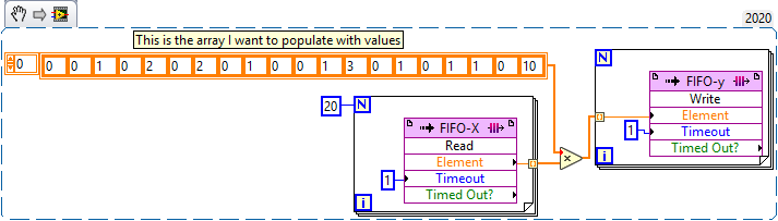

I have a VI deployed on an FPGA that I want to populate an array on. See the example below, where an array of 20 SGL values is stored on the FPGA, then used in some sort of mathematical operation. This example is representative of the problem I am trying to solve. But in my real code, the array is much larger (100 + elements)
How can I populate the array without doing it by hand?

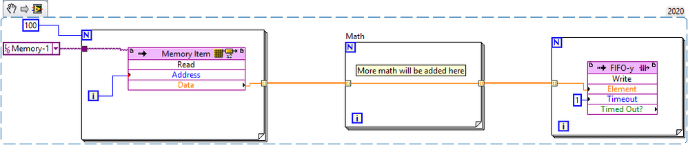

  4. I tried to set up a memory item (see below) that stores the data in the Block Memory and uses an initiation VI to load the memory. However, I can only load 1 data point per cycle so I have to wait for 100 cycles before my data can move on. So, I would really like to just insert values into the array constant.
This brings up the bonus question, does building an array by using the array constantly take clock cycles? For example, if I have an array constant of 100 values, are all 100 values available at the first clock cycle or do I have to wait for 100 clock cycles for them to become available (like the memory example).

Hi, you can always use scripting to set the value of the constant programmatically.
The difficult part is to get the reference of the desired constant in the block diagram.
Here is a script (LV2020) that can do that for any saved VI, within any target.
The constant can also be of any data type (not only array).
However, since you cannot set a pre-build VI for an FPGA bitfile, you will have to run the script manually before building.
At least you can set the value with a customizable initialization code...
I wish that NI would allow to add pre/post-build VIs also for FPGA, or even provide some sort of structure that would allow such initialization directly in the FPGA code, which would be pre-compiled on the PC before passing to the FPGA compiler... Let's dream 😄 !
