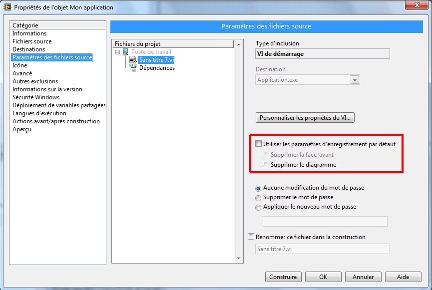

For your information, you can show the diagram of your application by unchecking the following elements in the properties of your specification :
