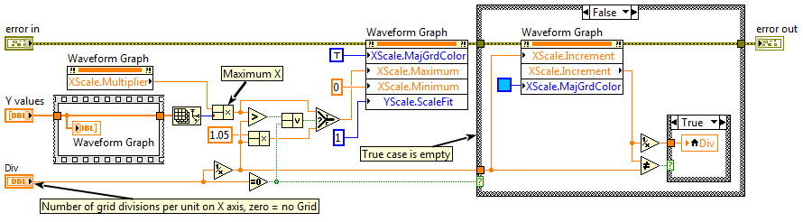

I can only second that : don't expect this feature / bug to be fixed anytime soon. And try to find a workaround. A hint, to my experience, is to avoid setting all the axis scale properties at once with the XScale.Range cluster. Try instead to set the individual elements in a specific order. I think changing the min and max always triggers an "optimization" of increments, even if you don't want that. Acually, even when you get the desired scale aspect, and even if you disable autoscale, writing data to the graph later WILL affect the scale divisions (increments), no matter what the data are.
I wasted tons of hours years ago (it was LabVIEW 8.something) to get exactly what I wanted in a non-inverted scale. Here is the code I wrote at the time, in case it could help you :
Good luck !
Vincent
