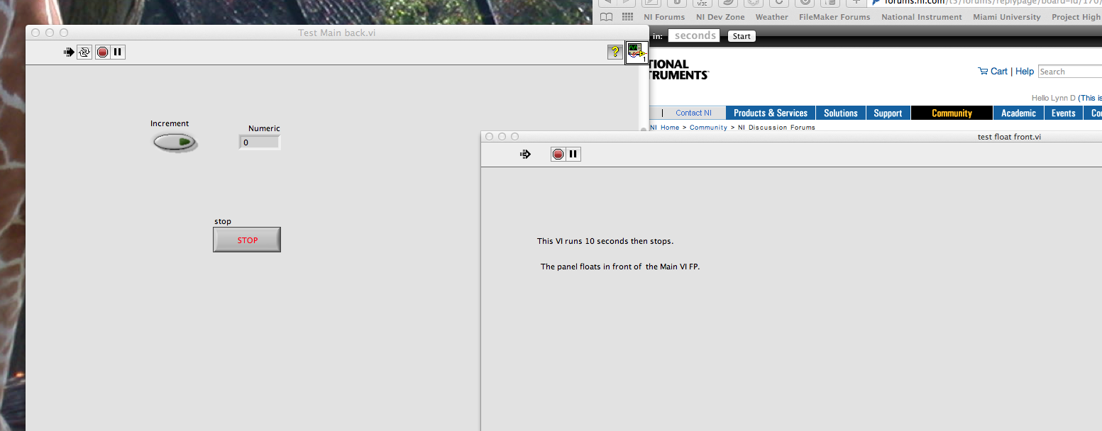

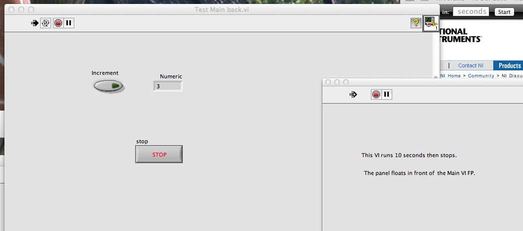

Thomas,
If I understand you correctly, the Float option under VI properties seems to do what you want on the Mac version. The first image is a screen shot taken jsut after starting Test Main Back.vi. The second image shows the result of pressing the increment button three times while test float front.vi is running.  VIs are in LV2013.
Lynn

Here it is saved back to LV 8.0. I did not test in earlier versions and did get a warning. So if the VIs are broken, please let me know.
Lynn
