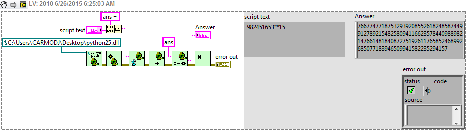

LabPython will work.  All you need is the dll and OpenG's free library.
The modulo result I get is 156086.  Is this what you expect?
Jim

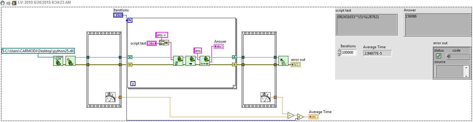

Accepted by topic author SuperbrainBug
Average time 30 microseconds?  Did I do this correctly?
Jim
