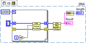

@Bob_Schor wrote:
I'm not looking, I'm not looking ...
No worries, the code picture is to small to be recognizable. Well, you can count five main stages, but that's about it.
Also remember that Bruce Ammons was slightly faster using a more intelligent algorithm. Mine is pretty much brute force. 😉
