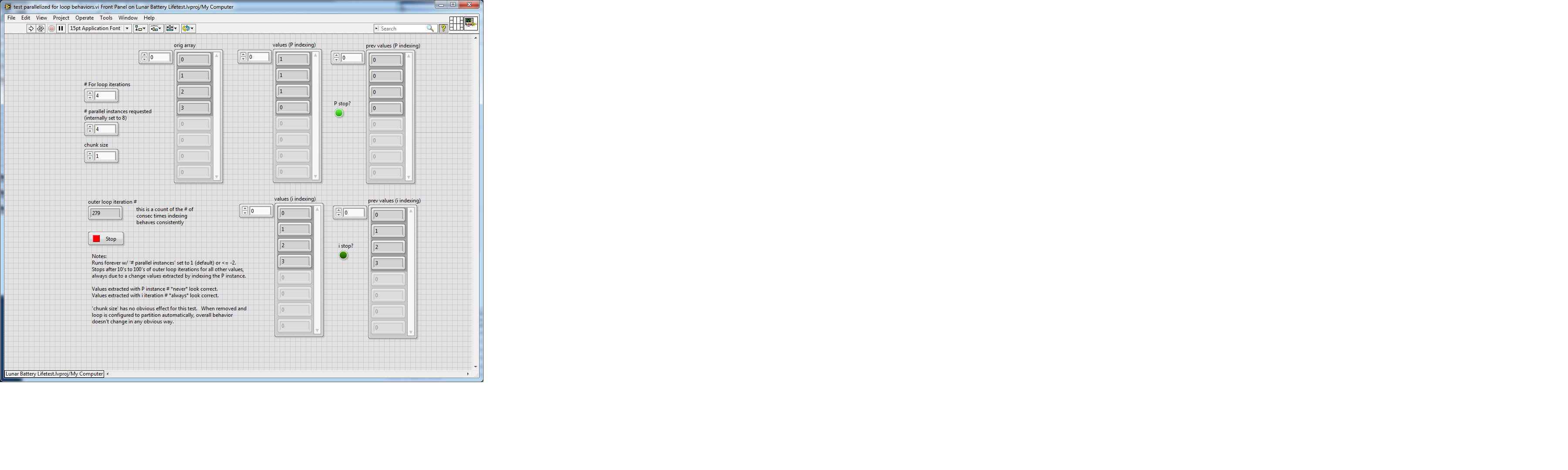

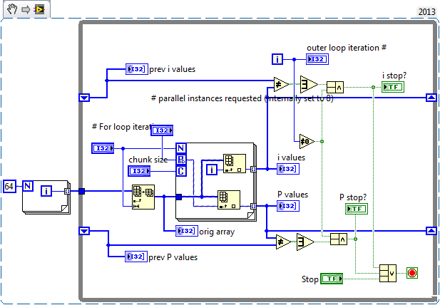

Ok, here goes.  This doesn't directly address the issue of reentrant instances, it simply illustrates that the parallel instance # P in a parallelized For loop acts in ways I have no explanation for.  The anomaly is somewhat consistent with my observations when trying to call specific reentrant instances -- occasional glitches where the "wrong" reentrant instance gets called.   Here, the occasional glitch is that indexing an unchanging array with the parallel instance # P doesn't always index to the same place.  Perhaps more importantly, it *never* seems to index to the expected / correct place.  Compare to the result using the iteration terminal i for indexing.
Snippet and screencap from a run below.  Sorry, multiline labels got reformatted by snippet-ing.

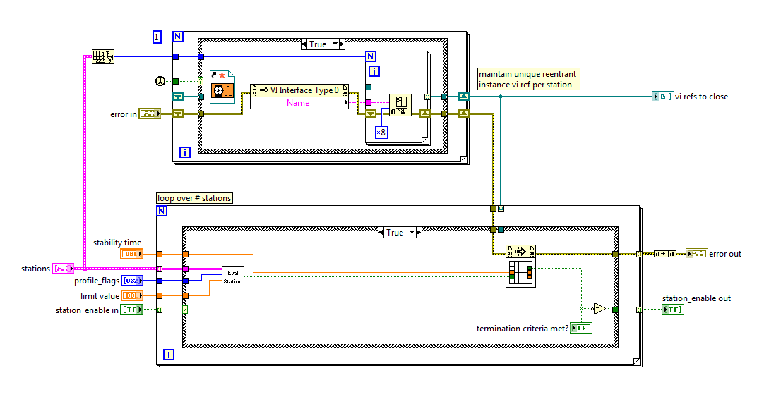

Well, yeah, that's pretty much what I settled on doing -- opening multiple clone instances of the processing vi with VI server refs, then using Call by Ref to execute the distinct instances.   I guess I just don't share your opinion that this requirement to open, store, and later close all the VI refs constitutes "Easy".  To me it seems like a pain in the neck when I can end up with more code tied up in managing the all the VI refs than I had in the original processing algorithm.

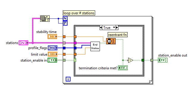

To illustrate, here's what I'd *like* to be able to do, make a direct vi call with some way to specify that I'd like to use a unique reentrant instance of my function for each *iteration* of the For loop:
However, what follows below is what I feel *stuck* with.  I'll live with it, b/c what choice do I have?  But the handling of the VI refs feels like clunky overhead.
