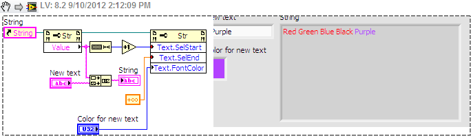

I modified it and got an unexpected result:

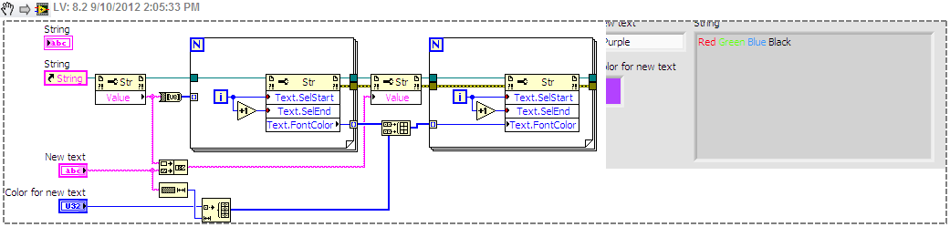

For two arbitrary strings and two arbitrary colors concatenated an arbitrary number of times you could do something like the attached. (Didn't put too much thought into it, so it's probably a bit "rube-ish")

Don't think you quite get what I am asking for, in your example you are making it all one colour at the end, totally not what i was after.
I have attached something more accurate, you can see what i am trying to get in the expected string and what i am actually getting
