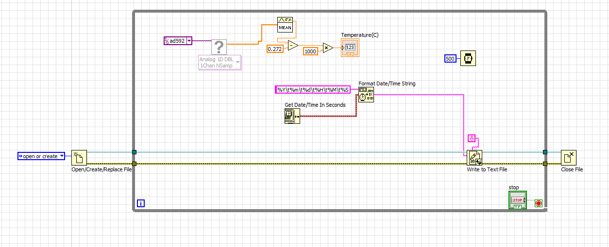

Just open the file before the loop and close it after the loop. Inside the loop, just keep writing to the file, no need to set the position.

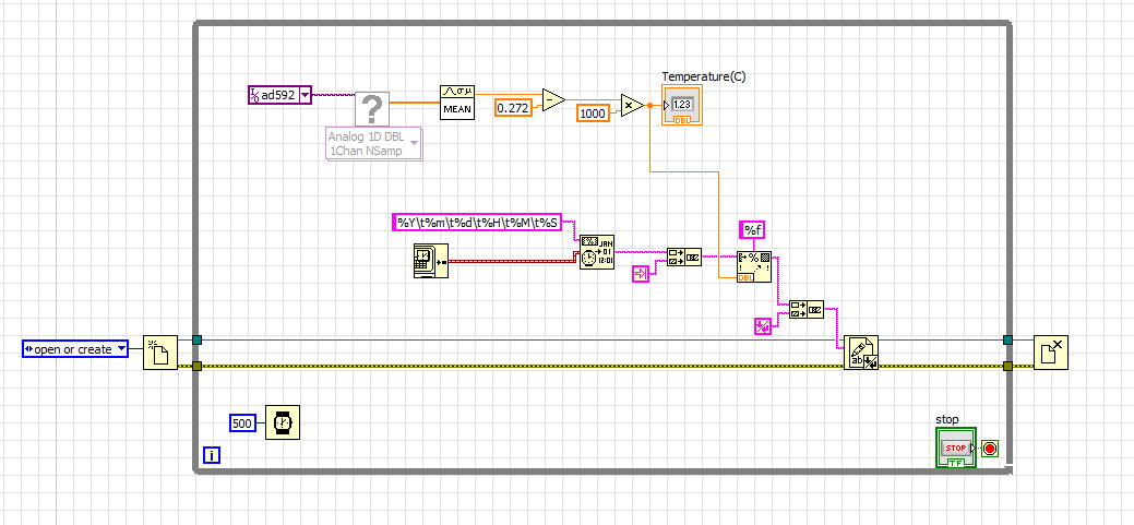

I knew that was coming next... This will put a time stamp and the temperature in columns with each reading on a separate line
=== Engineer Ambiguously ===

You do not need to wire the TAB constant to the Write To Text File vi.
I just noticed that It was still there in my original reply

I can't thank you guys more! It works! :manvery-happy:
Thank you and have a great week!
