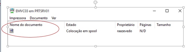

When i am using Print Report VI, from Print Report Generation, Labview wont print standard report type, using Uniflow Canon system printing, because there is no document queue name, so the document is deleted from printer queue.
If i use another system or local printer everything works ok.
Someone nows how to solve that, how can i the set document name print queue name from Labview ?
I need to use standard type report because i want the user to select printer device, directly to a printer or to PDF printer. If i use "HTML" type report i can print but dont works PDF printer selection.
