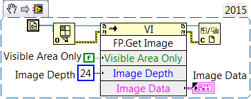

You can use the Front Panel.Get Image method to get the image and then save in the format you want.
You may also use the other method called Get Image Scaled.
The Image Data cluster can be used as input to the native image formats that LabVIEW supports (JPEG, BMP, PNG).

I also tried  your advice and the image quality is very very bad( for image in maximize mode).

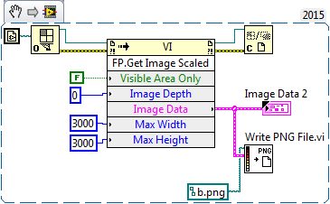

1. What image extension did you choose? The compression might cause some loss in quality.
2. Did you maybe try using "FP.Get Image Scaled" method?
This one will enforce producing a picture with certain size preset by the user, whereas "FP.Get Image" will not allow for specifying particular resolution, which frequently leads to lower picture quality.
