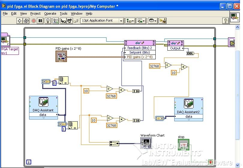

I try to make position control by PID controler using LabVIEW FPGA tool kit my servo motor work range of voltage between -12V to 12V ,

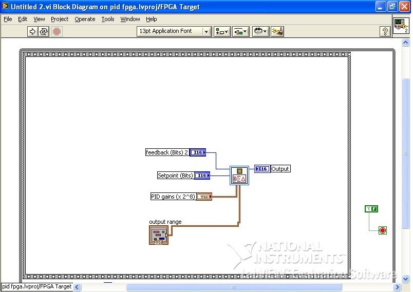

FPGA Kit that i used is spartan 3e ,my small project plan required to read the reference positon & the feedback signal using NI DAQ,by using host interactive mode i send the data to FPGA ,FPGA work as a processing that contain the PID block to generate the controll signal,back again to main program i received the output signal and bring it out from pc to servo motor using NI DAQ as shown in the figure>>
Main VI
FPGA VI

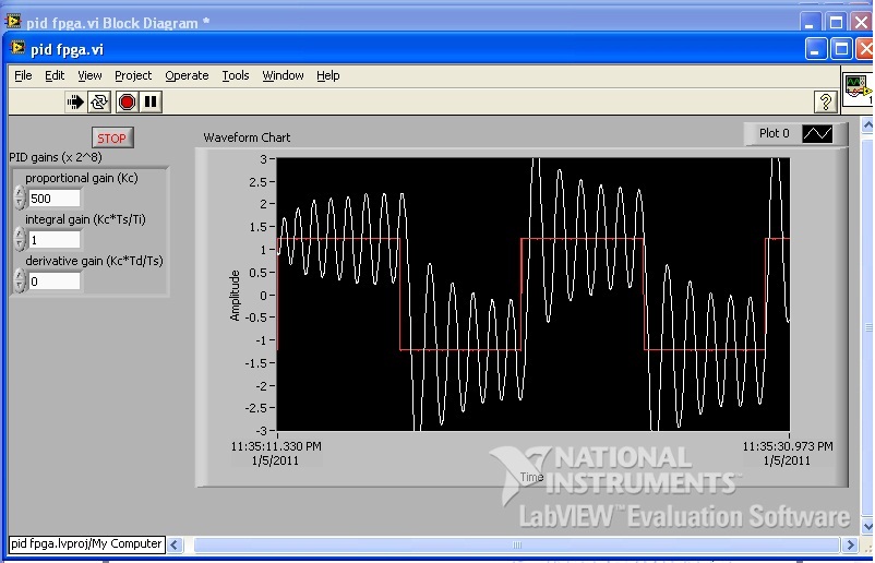

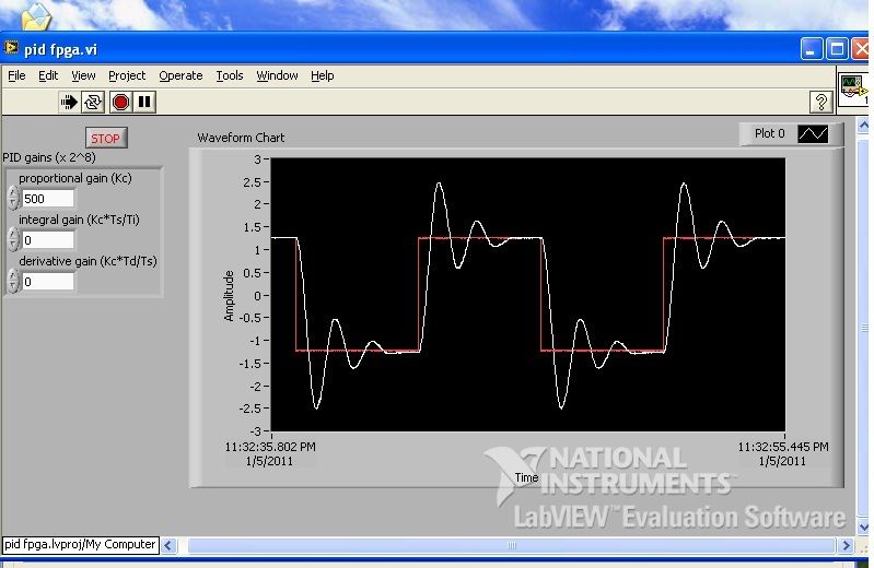

my problem if i change the derivative gain from 0 to 2^16 the response of motor not change as shown in image
second problem any value for integral gain make the system unstable as shown

Are you entering random numbers for the gain values? The maximum derivative gain is just under 128, because it's a signed, fixed-precision integer with 8 integer bits. A derivative gain of 1000 is out of range, and probably has no effect as you're seeing. Conversely, an integral gain of 1 is likely much too high. Try setting that value to something like 0.01 and see if it's still so unstable.
The correct way to do this is to use a tuning procedure such as the Ziegler-Nichols method to calculate initial gain values, which you can then slightly adjust by hand if necessary.
Why are you doing the PID on the FPGA, but taking the output back up to the host? There's no need for the FPGA in this situation, use the standard LabVIEW PID toolkit instead. Once you have that working, you can consider moving the PID to the FPGA if the IO is also on the FPGA.
