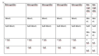

Word.pngWord.pngI am trying to generate a table in Word from the report generation toolkit. And when I'm saying "trying" I mean succeeding until just 10 minutes ago. With this VI I used to be able to save tables just fine. When I tried it just now the results are pretty bad. The resulting table reads: Table.JPGTable.JPG
Of course, since this has always worked flawlessly on my and the customer's computers, it work well on my colleagues computer as well.
My Versions of everything are: Word 1706 (Build 8229.2073)
Windows 10 64-Bit, LabVIEW 2011SP1 with corresponding RGT
His Versions are: Word 1706 (Build 8229.2073)
Windows 10 64-Bit, LabVIEW 2015SP1 with corresponding RGT
What can cause this problem? And how do we resolve this quickly?

When I dig into NI_ReportGenerationToolkit.lvlib:Word_Insert_Table.vi there is a comment that says "New in 2012: Setting the cells in a loop without using the clipboard".
Since you are using LV2011 with Windows 10 64-bit the issue could be related to that. Are you using the clipboard for something else at the same time?
