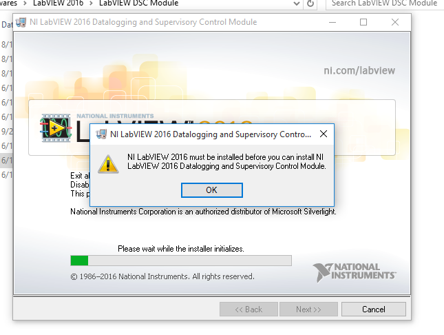

I am trying to install LabVIEW 2016 64-bit on my windows 10 64-bit.
the problem is: although labview is installed and working perfectly, when I try to install DSC module an error appears and states that LabVIEW is not installed!!

The DSC module is supported on a 64-bit OS but not using 64-bit LabVIEW so make sure you have 32-bit LabVIEW installed.

Thanks alot. I reinstalled a 32-bit version and now everything is working fine.
