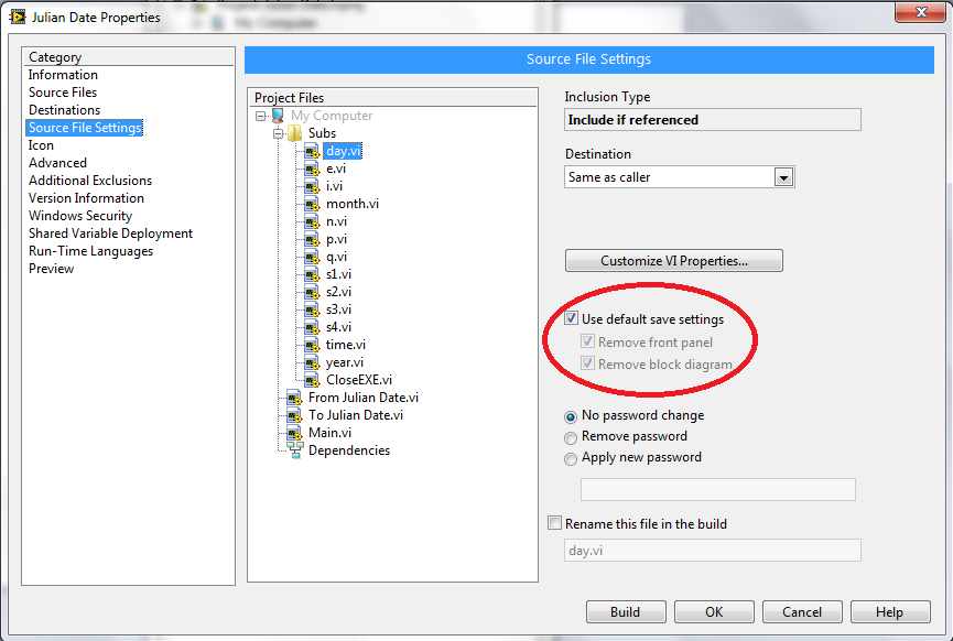

I can't be 100% sure, but this sounds like you remove the front panels from your subVIs. When you build an EXE the default setting is to remove the front panel and block diagram from the included subVIs. You can change this setting on a per file basis under the "Source File Settings" in the properties of your Build Specification.
